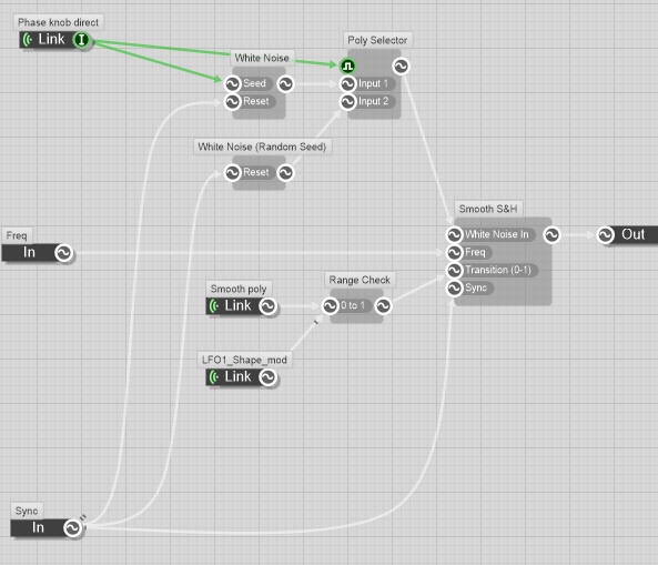

I just finished with throwing in MVs Noise (Random) S&H now :)
Since stage0: doesn't care being fed value at "poly stream start" it seems... I split
the noise into two versions, unfortunately always running at the same time to avoid schematic reloads :D
I also wanted a mode where seed is fed by note pitch 0-144 but that is probably just as much of a problem as
feeding any other poly to stage0: operations...?
