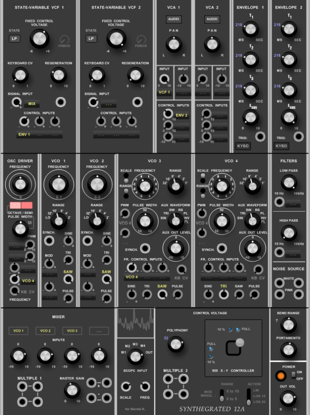

While we're gettin' all modular here - briandc at LinuxMusicians expressed some interest in the Synthegrated 12A (based on a custom Moog Synthesizer 12), so I did that one up:
Synthegrated 12A_copy.jpg (228.22 KiB) Viewed 28125 times

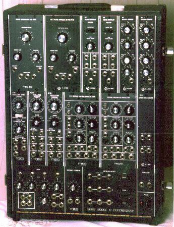

The custom 12 I based this on swapped out the Fixed Filter Bank for a fourth VCO, a second VCF, and a second VCA, and is I think similar to the setup Bernie Krause had on his 12.
Moog custom 12.jpg (53.7 KiB) Viewed 28125 times

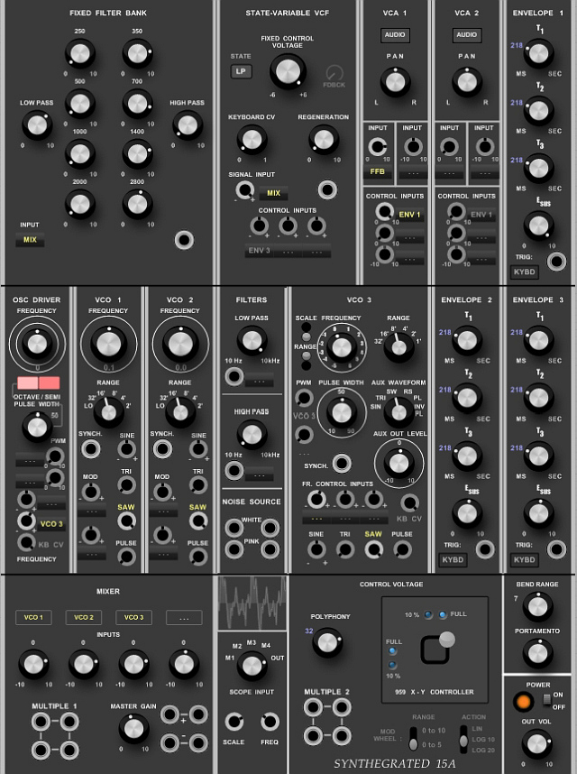

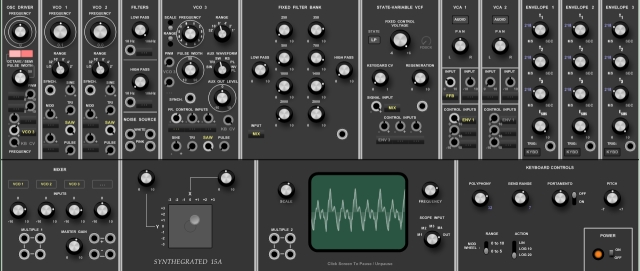

And here one based on the Moog Model 15 Synthesizer. Only swap out here is the substitution of a third EG for the attenuators module, since all the inputs and many outputs have built-in inverse-able attenuators; and who doesn't love an extra envelope?
Synthegrated 15A:
The attachment Synthegrated 15A_copy.jpg is no longer available
Synthegrated 15A_copy.jpg (235.21 KiB) Viewed 28092 times

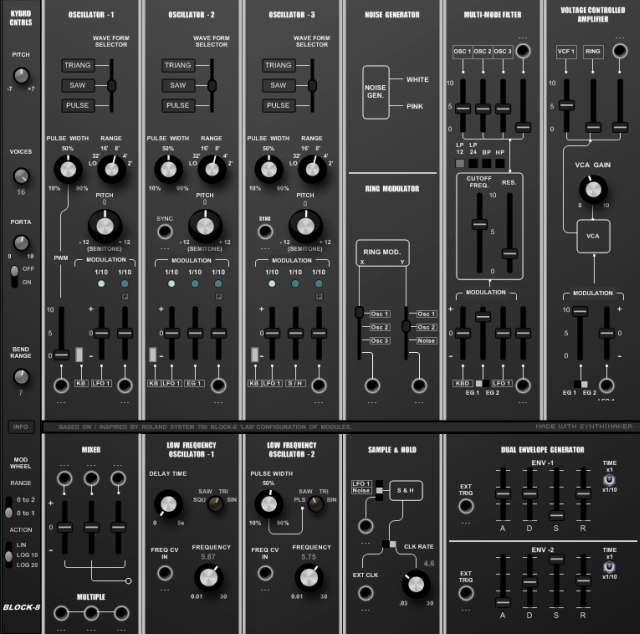

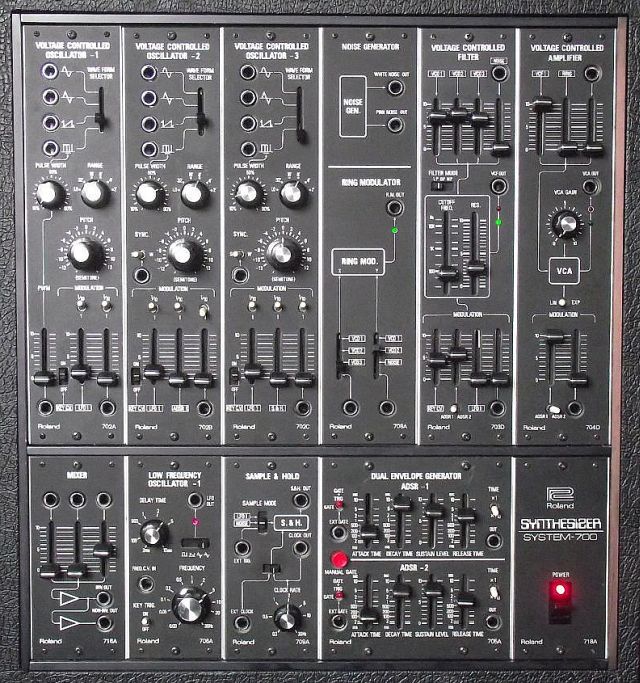

More modular madness - Rolend Block-8, based on the small 'Laboratory' configuration of the Roland System 700.
The 'jacks' are actually drop-down menus.
Rolend Block-8_copy.jpg (148.55 KiB) Viewed 28062 times
Block-8 'Lab' System 700_copy.jpg (139.66 KiB) Viewed 28062 times

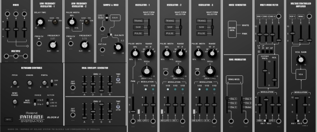

And a horizontal-layout version for those whose hosts can't scroll up/down:
You'll find it in the same folder as the original version.
Rolend Block-8_horiz_copy.jpg (91.51 KiB) Viewed 28059 times

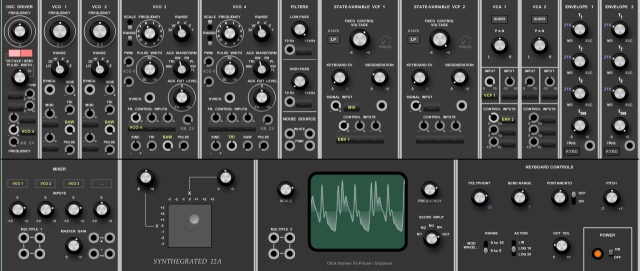

Did the same with Synthegrated 12A:
Synthegrated 12A_horiz_copy.jpg (103.11 KiB) Viewed 28052 times

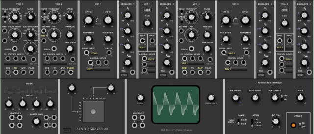

Something different - a Moog modular emulation with an arrangement of modules selected to reflect the basic voice components of the Yamaha CS-80 - namely two sets of VCO-VCF/Env-VCA/Env, plus an LFO. Of course being modular one can connect them any way one wishes.
VCO-1 patterned after the Moog 921, but the other two have had their Aux sections replaced with internal PWM LFOs (like CS-80).
The filters have also been changed to reflect CS-80, having an HPF section in series with an LPF, with common modulation inputs and keyboard track. Unlike CS-80 the LPF is 4-pole.
Synthegrated 80 :
Synthegrated 80_copy.jpg (101.56 KiB) Viewed 28022 times
