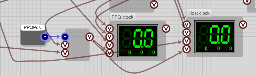

Nubeat7 wrote:the problem is when you start to play on any position it starts on the position you are and not synced to the beat position in the song
Does seem like an easy fix to get that feature your after Nubeat7.
I started by turning the Clock Module to float. Created a 2nd second Clock that runs off the ppq trigger
timer. So there's two sets of numbers to choose from, to build your seq system, or midi output from.
Then added ppq primitive..and just routed it into the clock....idea is ok so far....
In the host, press along the timeline, clock changes with it...functions just like the "start" knob
in the X11.....

Here's a new midi timer based on the default custom ticker.
Offers individual control of all Midi note/Velocity/Duration/Midi channel/On-Off.
Steps can be changed on the fly. Minimum step value is 2.
Don't know what the max is, I punched 1000 into the selector and still got a result.
I've stripped this fsm down to a "default template" style.
Everything is in 1 module, you can see it all at once.
Custom Seq Ticker_BV.fsm
(111.02 KiB) Downloaded 2361 times

Here's an updated version.
I squeezed out a bug or two.
To further test it, I added a hostclock and stuff to keep tempo selections in time with host.
This also allows the tempo to controlled/automated at every bar.
Custom Seq Ticker_BV_v2.fsm
