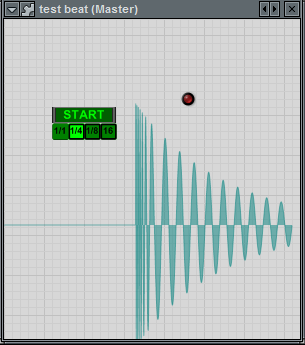

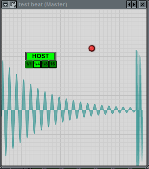

ok so tested PPQ Timer V3
from what I can see, there is still a variation of the timing. Now that is based off my scope grabbing samples.
Surely it should grab each beat at the same time? So there should be NO variation?
So A kick on every beat and the scope changes from
to
as you can see slight variations. Always changing.
Now lets see only one kick on the first beat . . . (snapshot taken on 2nd beat)
This shows a few samples are shifted around the synced ticker. Its not 100% but I cant think of why it would be shifting like this if it was. Also the delay in grabbing samples from PPQ ticker is around one beat.

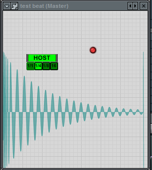

As far as testing goes:
Using 'Host tick' grabs every 8th or 16th. . . its quite fast & not every beat. . .
So tempo tick does it correctly. Maybe a division of the 'host tick' to every beat is necessary?
Also using 44100 grabs too many samples (unless you are using a bpm of 60)
Acrobat's "samples per beat" works perfectly, no more no less.
Are these samples being displayed at schematic grid equivilant???
There's no background markings to "gauge" things from...know what i mean??
Yeah its just against the schm background. When its exported to vst it has the grids which are static. So its easy to tell when they are off :)
I know we are SO close to this because it is only ±100-200 samples off each beat. . .
It cant be the way we are doing things because logically they make sense (to me anyway). . .
In my case:
Detect when there is a beat
When beat trigger received, grab audio snapshot of x samples (x = correct amount of samples per beat)
Display snapshot
Simple. . .hmmmm :oops:
Okay, lets say that the timing components we are using are correct, they are 100% accurate & WE KNOW THIS. . .
Then maybe there is a delay in the detection & sending of the beat trigger TO the actual grabbing of audio & drawing of graph.
The result would show us that every beat the sample would be off slightly (caused by the delay in triggers) BUT IT WOULDN'T JUMP AROUND! It would stay exactly in place . . . so why is it still moving around?
This leads me to think that the drawing of the graph is correct but NOT the timer to the beat. :idea:

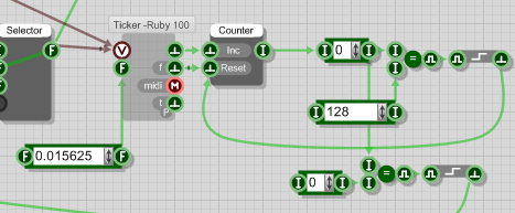

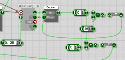

My main focus at generating a error is this......
Look at the v3 circuit. Notice it works simply by holding the user's selection
and delivering it at 0. the beat starts at 1.
I know if the user times his selection at point 0, the S/R accuracy seems to take care of it,
But I can't help thinking there is 1 in 16 chance of an error happening.
So i have been playing around with these two parameters.(ticker time and count number)
This seems to "tighten" that gray area up, no human is going to be that fast...
So if anyone gets an error, the first pic is probably why, and second pic is the Fix.
At the moment I'm leaving it as is with a host tick and a count of 16. No errors yet.
I new if took it up, sooner or later I would get an error, because the circuit is not "optimized".
Next i went up to 256 on the count and the circuit, as suspected, could not keep up.
The real interesting part is when increasing the count and the the timer like this,
watching those 128 numbers fly instead of just 16, sort of "opens the door for sub-sampling".
Based on this....
The circuit should be re-created in ruby, with a ruby count as well.
That will allow us to get those monster tick rates discussed earlier, enabling a more "pro" solution.
(I would have used Trog's Ruby counter, but i got a slight re-draw issue with it, one of the values
won't re-draw for me, so i can't use it for testing until work out why I'm not getting an immediate
re-draw under certain circumstances.)
