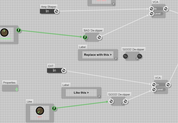

Since you're going into these schematics, it would be cool if you could do what I'm going to do, which is look out for any de-zippers that have 'green' (float) inputs rather than stream inputs; just a matter of deleting them and replacing with the standard ones that come in the toolbox. Spogg noticed some glitchy behaviour caused by these and replaced them in the synths he worked on.
Is is possible to post a screenshot as an example ?

De-zip surgery:

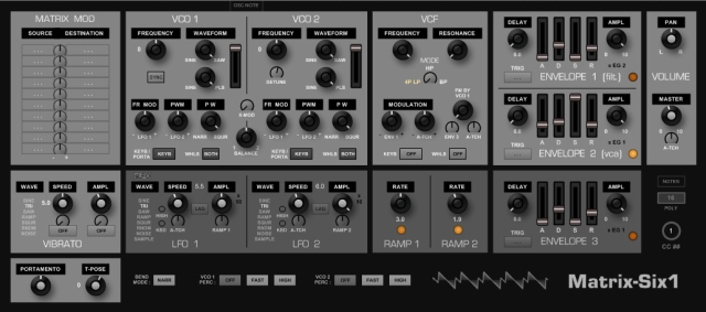

I just finished an Automation-friendly clean-up of Matrix-Six1_myOsc.
https://www.dropbox.com/sh/kpbgw7wztyue ... oyLYa?dl=0
Matrix-Six1_myOsc copy.jpg (91.07 KiB) Viewed 33626 times

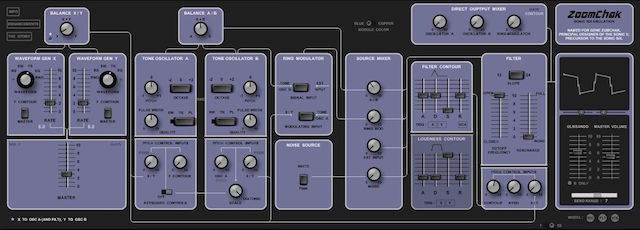

And, the Sonic Six (Zoomchak):
https://www.dropbox.com/sh/5ev5rrfsoztv ... ZZKka?dl=0
ZoomChack copy.JPG (40.6 KiB) Viewed 33626 times
