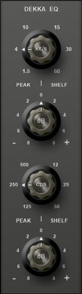

Finally finished this up.
It uses Martin's 2nd Order ZDFs and 1 pole Shelf Filters; sounds very good.
The Shelf freqs include 30kHz and 60kHz - not sure if they're even doing anything; Martin included a warning about Nyquist limitation in the Peak filters used, but not in the Shelf filters, so -- ?
I selected Q for ea. Peak frequency based on the Cello Audio Palette Mastering EQ:
10kHz: 1.0
4kHz: 0.75
1.5kHz: 0.5
500Hz: 0.5
250Hz: 0.75
125Hz: 1.0
So, the slopes get more gentle at mid freqs.
Those Decca boys chose their limitations well.
This a a very subtle EQ for polishing a final mix; not for torturing your synth!
Thanks tons kortezzzz for the rotating labels - so cool!
You can choose black or blue!
Dekka EQ fsm.zip
(1.52 MiB) Downloaded 567 times
Dekka EQ.jpg (13.81 KiB) Viewed 12884 times

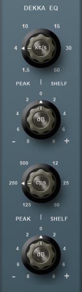

Dekka EQ_blue.jpg (15.62 KiB) Viewed 12884 times

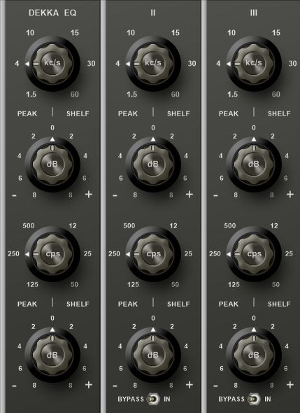

This zip includes a version with three units, two of which can be bypassed.
Dekka EQ.zip
(8.61 MiB) Downloaded 572 times

Re: New project idea
Awesome! Perhaps add some scratches to make it look really old. :lol:
Under the hood, I would recommend the Peaking EQ and the shelving filters from here. The Peaking EQ you have picked is geared towards modulation (irrelevant here). Moreover, the new filters will handle center frequencies above Nyquist (the ones in your schematic won't).
Edit: I took the liberty to carry out these modifications. Discovered a little bug in my shelving filters along the way, so thanks!

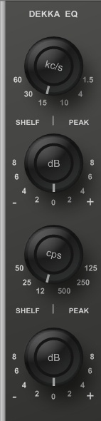

I should have posted the 3.0.6 schem to start with (I keep forgetting about that, since the 64 is still a moving target).
The original's been updated with knobs that function more like the hardware.
Dekka EQ IIe.jpg (30.98 KiB) Viewed 12834 times
Dekka EQ_IIe.fsm
(436.85 KiB) Downloaded 534 times

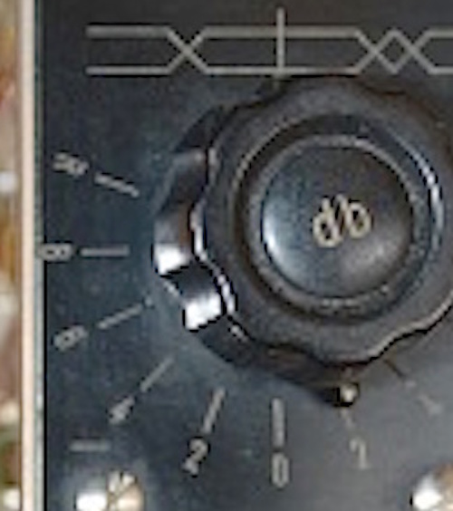

BTW - there's still a mystery about the Decca EQ that remains - I posted about it on Gearspace, but no has offered a guess about it. There is an additional position on the 'db' switches at full CW (past '8'), that appears to be marked 'R' - what could have been the function of that position?
Decca EQ copy.jpg (69.03 KiB) Viewed 12834 times
The only thing I could think of was that it stood for 'Reference', as in reference tone; but that seems unlikely, as these were passive EQs. I suppose it could have been a routing switch for an external tone generator?
Oh, I see. Never mind, I replaced those filters in Dekka EQ IIe, too. BTW the shelf-peek sequence in the bass seems reversed, don't you think?
I have no idea what what R stands for.
