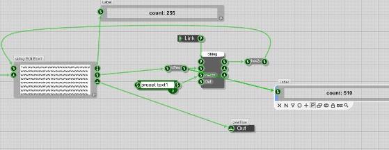

Also, right now you are counting the actual strings before they get converted into hex and thats not accurate. You need to put the length after the String to Hex, because thats the actual values that go into the preset text.
Re: save multiline text in preset
adamszabo wrote:Also, right now you are counting the actual strings before they get converted into hex and thats not accurate. You need to put the length after the String to Hex, because thats the actual values that go into the preset text.
Please see this image. There is the reason by which I connected the counter before the conversion: I prefer to see the real quantity of chars.
In addition, although 255 characters of text mean 510 characters in hexadecimal, the presets work fine, which caught my attention ...
- snap.jpg (20.57 KiB) Viewed 27105 times
