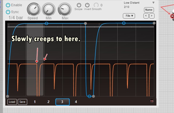

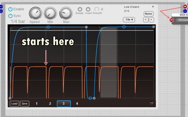

It also seems to creep in time . Set to 4 beats , envelope is set to 1/4.
Starts here .
And creeps to here and further given time , this was 1 minute.
creep 2.jpg (68.13 KiB) Viewed 25244 times
PS: Still cannot get it to "sync" as in placing a kick at first downbeat and having it appear in the beginning of the window. Confused at this point.
