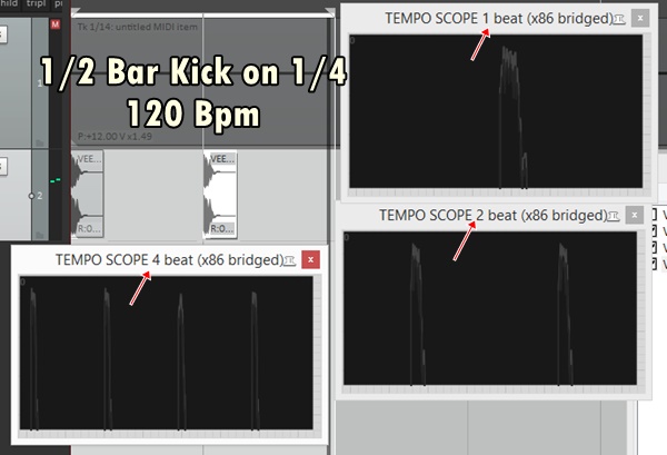

Re: Slower Largescope
Why this offset ? Could I make it start at the beginning ? I was having trouble with this so I just exported the scope as a VST for testing but it seems that a kick placed at the beginning shows up in the middle of the scope ?
- Offset.jpg (56.38 KiB) Viewed 25234 times

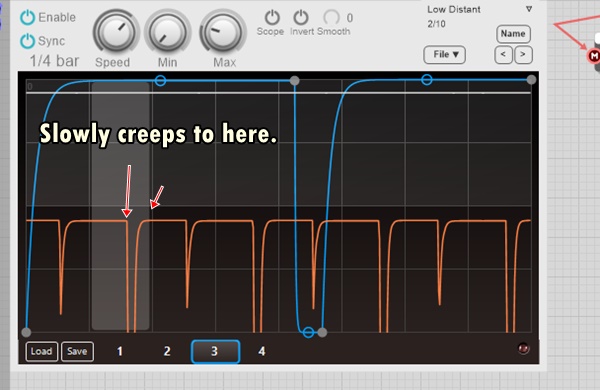

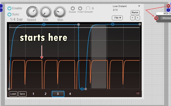

It also seems to creep in time . Set to 4 beats , envelope is set to 1/4.
Starts here .
And creeps to here and further given time , this was 1 minute.
PS: Still cannot get it to "sync" as in placing a kick at first downbeat and having it appear in the beginning of the window. Confused at this point.
