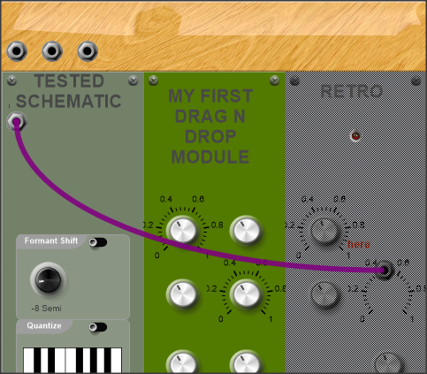

The ARC module cable idea from yesterday is done! got som live into behaviour with it.
anyway right now changing order will disconect cable, lost M area and so... It only works properly if "tested schematic" is "before" in order or "after" and you never drag over it with pluged one ...but it dont break my happiness of what it becomes :D .
Snap 2020-11-26 at 21.31.43.png (73.11 KiB) Viewed 21482 times

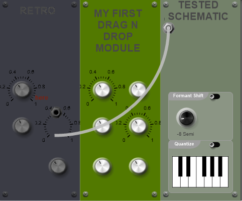

Just quick update - its free to move gui xy coordinates for cable inp. and outp - drag what you willt now, cable still![/u]
Drop _3.3 + cables2 ARC3 2xS o-oll3.fsm
(1.59 MiB) Downloaded 1072 times
[u]
it looks like this now:
Snap 2020-11-28 at 11.48.49.png (149.35 KiB) Viewed 21447 times
