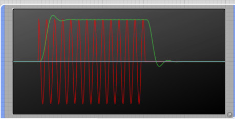

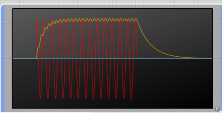

Here is a pulsewith different envelope follower filters:
yellow: common single pole with different attack and release times.
green: 4-pole Butterworth filter
blue: FIR
blue: FIR

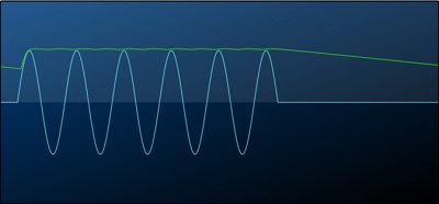

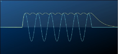

Images show a sine-wave signal which is amplitude modulted to have a 'burst' shape.
Signal shown with the 'gain signal'.
First image (gain signal in green) shows the ripples for a 100Hz signal with release = 50 ms.
Second image (gain signal in yellow) shows the ripples for a 100Hz signal with release = 5 ms. Much lower than the assumed minimum.
Third image (gain signal in red) shows the ripples for a 1000Hz signal with release = 5 ms.
From these images it seems to me that ripples are a none-issue (50ms release minimum).
Again, I'm quite new to this... Just asking.
Does this make sense to you ? Is this assumption good?
Can we say that 'first order IIR' can be used for Release greater than 50ms and signals 50Hz and higher?
Any comments are welcomed. Just learning here...
- IIR_1stOrder_100Hz_Att0.5_Rel50_small.jpg (13.56 KiB) Viewed 29342 times
- IIR_1stOrder_100Hz_Att0.5_Rel5_small.jpg (13.96 KiB) Viewed 29342 times
- IIR_1stOrder_1KHz_Att0.5_Rel5_small.jpg (18.16 KiB) Viewed 29343 times

hey mate!
you have noise I the first and third plots,
also quick release is nice IMO
Sorry - please elaborate. Are you reffering to the images? Mine or Martin's? To me they all seem OK.
How does windowed RMS look I wonder.
I'll happily run some RMS tests and share the plots. But, let's first concentrate on the PEAK ones...
What do you mean by 'fast' release? Faster than 50ms?
My question is if we can assume that: "For fast release (shorter than 50ms) one can not rely on first-order IIR. For abover 50ms, it is good enough".
Thanks,
Rocko
Re: K2 - Peak Compressor
I was referring to your images Rocko,
the first and third ones start with some amplitude already.
Yep, faster than 50 ms.
