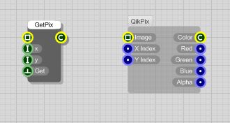

My stuff is simple (I think :) ) in comparison to your work - I don't even know how you think up stuff like that in Flowstone, but I'm learning thanks to the great teachers here on the forum !
I am trying to load a bitmap, then with X and Y inputs access the pixel at that point, just like the "GetPix" primitive BUT AS FAST AS POSSIBLE.
For one project I need only about 128 x 128 pixel resolution, so at 44100 that allows me to traverse the full array (if needed) in about (128 x 128) / 44100 or 0.4 seconds. But I really only need to access about 2048 pixels per array traverse (random lookup) so that is even faster at about 2048 / 44100 or 0.05 sec (20Hz). Eventually I will get a low resolution video image and look only at certain areas (pixel locations) but I have to do it fast - again "GetPix" is too slow unfortunately :(
You could even use this to scan a BMP Image out to an RGB LED XY Pixel Array, maybe even with slow video at low resolution - that would be cool to. But that is yet another project...
(For another project I need to access larger resolutions say up to 4096 x 4096, but that is for a different time, much later)
Just a Fast Version of GetPix is Needed
Think of it like Blue (Stream) inputs and outputs instead of Green (GUI Speed) inputs and outputs
I don't need color (C) out even, just RGB & Alpha, or even just RGB, or maybe HSB.
Hope that is a bit clearer, and thank you for the great discussion !

Posted: Fri May 27, 2016 5:40 pm
aronb wrote:I am trying to load a bitmap, then with X and Y inputs access the pixel at that point, just like the "GetPix" primitive BUT AS FAST AS POSSIBLE.
Like this?
StreamGetPixel.fsm
(170.65 KiB) Downloaded 1053 times
