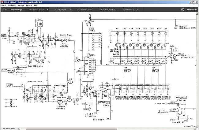

thank you BobF,
and here my 2nd schematic with 74154 (2, 4, 8 and 16 steps) - the other variant uses the 4017
(reset doesn't operate yet) I've been looking for the other step modes 3, 5, 7 etc.
in the attachment the service-manual of the Yamaha-CS-30 and the new fsm-file
cheers
TSt
cheers
TSt

Re: Digital Logic
@BobF, @Roxy
after some times, I've got now a solution for an operating stepmode in this 8-step-sequencer
some help or explanation would be useful: to using the seq. you have to initialize the S and R input of the 4017
internal with 1 (H) and external his S with 1 and R with 0 (?), perhaps a better solution with gates or similar
components would be more practically (?)
I've been looking else for the "stop after one cycle" - mode in this seq.
at last: in Maxmsp I'm using the loadbang, loadmessage routines to intialize a Max-patcher, does these mean in FS only
numbers (int, float), variables, strings are useful?
thanks and happy maxing
TSt
TSt
