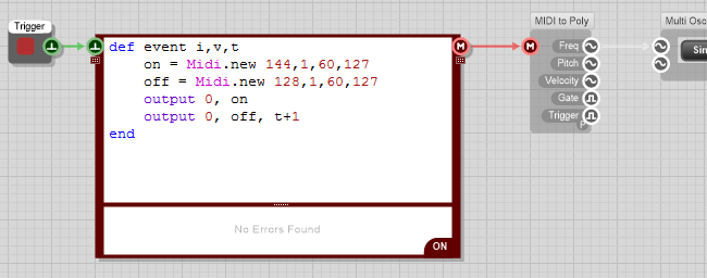

Posted: Wed Mar 16, 2016 3:07 pm
by Nowhk
I've just see you had posted this message time ago, Tronic: "and then writes and reads continuously from memory"
It seems that outputs (the bridge between Ruby back to FlowStone) could run at different times from which they are called. If this is true, how can (for example) MIDI be sync internally of FlowStone when I create/manage/trigger them with Ruby (that is 100Hz accurate)?
I mean: if I generate a MIDI message and I stop it after 1 second:
Ruby MIDI Note On-Off.fsm
(8.01 KiB) Downloaded 918 times
who can guaranteed to me that it play exactly at time t and ends at time t+1? Ruby events are sync/scheduled to run at those fixed times, yes, but later MIDI will takes time to process/output to the following step (i.e. from my code to the input of Osc).

Posted: Wed Mar 16, 2016 6:40 pm
by Tronic
However, as the manual says when a primitive external Audio is on,
it is synchronized and processed with the same sample rate,
but from my test I have determined that it is processed with an identical frequency,
but equal to the size of the audio buffer.
If the trigger is generated by a green, is not as much as it is ensured that the "t + 1", actually ends at "t + 1",
but we must think, when exactly the green will run?
And that is where the synchronization fails,
And in any case the "t + 1" is guaranteed.
Then also consider this:
In my opinion, from c++ side,
the Midi Queue Buffer does not run in the same thread-function of the audio,
so does not guarantee synchronized performance of it.
Re: How "draw" method is executed from Stack in FlowStone/Ru
Posted: Wed Mar 16, 2016 8:05 pm
by Nowhk
Tronic wrote:If the trigger is generated by a green, is not as much as it is ensured that the "t + 1", actually ends at "t + 1"
Ok sorry, I've wrong init point. Let says that the trigger is generated by a Frame (from mono to frame prim), at a fixed speed by DSP code (audio): Ruby events runs exactly sync with it (I trust this).
But what about MIDI (i.e. the part I'm interessed)? That's the point. I don't care if Ruby event execute in time, I care that what I create inside this task is executed in time :D
Once Ruby event run, to generate, manipulate and than send my new MIDI to the output (and than processed back to FlowStone/C++ again) it will requires overhead. Is it included in the Ruby/event time syncing this? :o
Tronic wrote:Then also consider this:
Is it normal that inside an audio development environment, MIDI (which is fondamental in audio) could be not sync? I don't believe in this... I think I'm missing somethings...
Posted: Thu Mar 17, 2016 8:29 am
by Nowhk
tulamide wrote:Flowstone's task is to sit as a slave in a DAW and react to everything the DAW requires it to do.
And what about if you use FlowStone as standalone application? (not my case, but just curious).
tulamide wrote:A midi signal comes in from the DAW, Flowstone sends audio out.
With delay compensation, everything is exactly on point.
With audio/stream, this is true, all is sync! Its also written and documented in the manual.
But... also with MIDI? They are "trigger" data types (i.e. green), and its written everywhere that green are not sync with audio (its the first/important rule I've learned in FlowStone). Since they acts as green, who can assure to me that they are treat in sync with audio? If DAW send event data (i.e. MIDI) and FlowStone has not a control rate sync with audio (because of the green nature), how can process audio sync with them? Or the story about unsync green is partial true for this kind of process?
I'm really confused here, and I'd like to understand this missing part of FlowStone (very important to me, but I can't got it since lack in documentation). Please, can you shine me?
tulamide wrote:But reading what you are complaining about let's me assume you don't want to create a plugin, but a host. Because only a host needs to be perfect in midi timing to be able to control the flow of things.
And if I'm just making an arpeggiator? FlowStone can't do it?
