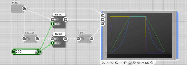

zucker1 wrote:I need a way to prevent These "large" step at the beginning of the transition.
Is there a way to Change the behaviour of the dezipper or a "code-Version" of an dezipper that i could modify???
The dezipper will respond to a sudden change by linear ramping from the last value to the new value. If you have only positive values (=delay times) to consider and you want slower ramping for low values and faster ramping for high values, you could sandwitch the deziooer by a nonlinear function and its inverse, respectively.The screen shot below illustrates the idea fora log/exponential pair (both base 2):
yellow - input step function
green - plain dezipper
blue - sandwiched dezipper

would you be able to post that schematic Martin? :)

HI Martin,
due i'm stuck on the old synthmaker, there's no 2^x and no log2(x) module.
i've tried to create an code block with
streamin xin;
streamin xout;
xout = log10(xin) / log10(2)
and
streamin xin;
streamin xout;
xout = pow(2,xin)
but the Output of the 2^x block delivers creepy negative values...
