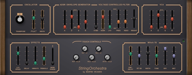

While this certainly isn't anything like Martin's plugin GUIs on his site, and kortezzzz will think this won't appeal to the kiddies, here's my take on it in a vintage ARP-style GUI, for all us old f*rts 8-) :lol: .
StringOrchestra copy.jpg (137.4 KiB) Viewed 22542 times

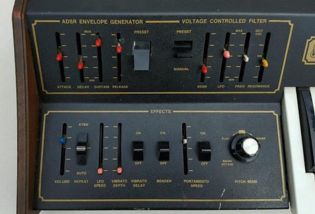

Patterned after the ARP Explorer I
Explorer CP copy.jpg (49 KiB) Viewed 22535 times
SOS_arpGUI.fsm
(1.7 MiB) Downloaded 1421 times
Only a few of changes to the schematic - 'Phat' Width control, wider LFO speed range, selectable PB range, LFO mod of Filter, Lo boost/cut added, Detuner simplified to a +/- 24 semitone control and longer EG times ('vintage' standard 10 sec.).

Kevin, this is a lovely design! I like it. However, I personally will always prefer a little bigger sliders, but the overall look and appeal is terrific. Very pleasing and solid. Cheers! :)
Re: String Orchestra Synthesis
You're right, I should at least make them a little wider.

If you're referring to my ARP-y version, yes the default settings it opens with are sort of brassy - if you open Martin's original, it sounds more like a string orchestra; just proves the wide range of sounds it's capable of.
