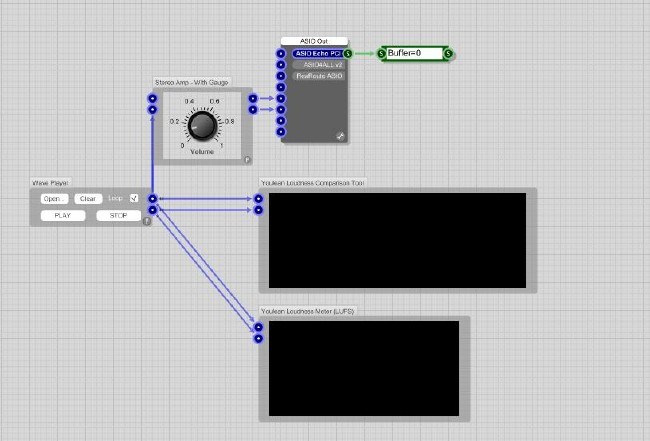

Hi Guys ...
Just wondering ... did I wire this up wrong ?
Re: Loudness Meter-Comparison Tool - EBU R128
This is a bug with ruby... Try to reinstall flowstone, or turn manually on every ruby component inside it...
hm ... that seems strange.
I use RUBY very often in my projects. I understand there are issues at times.
I think I've gone through the whole schematic, searching for RUBY modules. Each that I found I reset ON/OFF.
NOTE: None of the RUBY's show any type of error report, but I reset them anyway.
No change in the result unfortunately. I'll keep looking.
Please ... if any other ideas where or what to do, I'd appreciate it. This EBU R128 is a function that I'd like to be able to use in my project ideas.
Thanks again ! Much respect for the level of work you've already put in developing this. Sure hope I can get it working
Is this working for you?
- Schematic1.fsm
- (6.15 KiB) Downloaded 1369 times

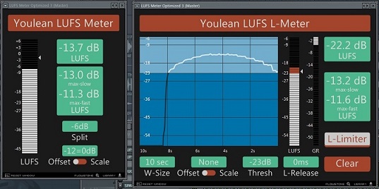

Anyways, here what is coming soon... I will probably post a schematics here...
- LUFS.jpg (59.48 KiB) Viewed 26522 times
Youlean wrote:Is this working for you?
Yes it is
I see real time readout.
