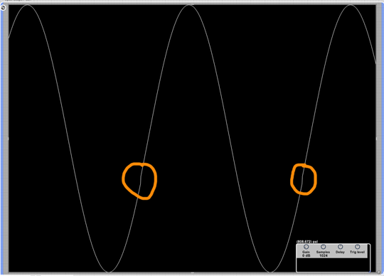

Thanks Martin. I can confirm that your demo doesn’t show a glitch. I added a “Steady Scope” which works with the analyser and the sine wave was indeed pure.
I re-tried the reader from your test and used the counter from it as well (just in case) but I still got the issue.
glitch on sinewave .png (31.96 KiB) Viewed 16477 times
So I’m puzzled!

If yo post a stripped down schematic which shows the glitch we may sort this out.
Re: Wav (Mem) to Float array issue.
Posted: Wed Sep 25, 2019 4:51 pm
Well, this is fascinating!
I stripped down the schematic to almost nothing and added you reader and counter and there was no glitch.
So I copied that oscillator back into the original schematic and still no glitch. :o
I just can’t account for this so maybe it was a weird FS issue, not updating the compilation correctly or something. I would say that it could have been my mistake but I had already changed for your reader and counter on 2 separate occasions previously.
Whatever the reason, I can confirm that it works great now. The wav changeover is fast and the CPU is lower than before. So I’m left puzzled but happy. :? :D
