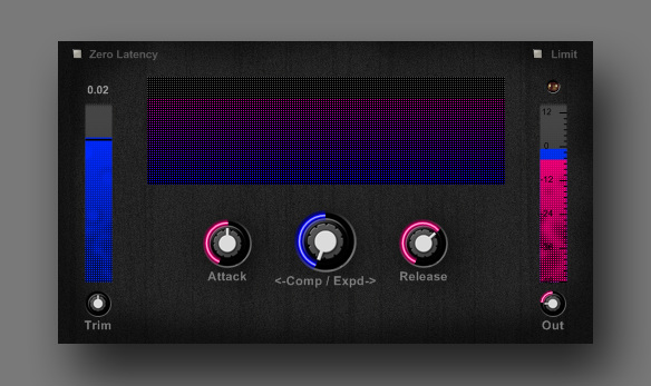

Even just transparent png overlays can do great things for GUI designs if you know how to work them though. The dynamics processor plugin I made turned out kind of neat. And things like this look great in motion.
