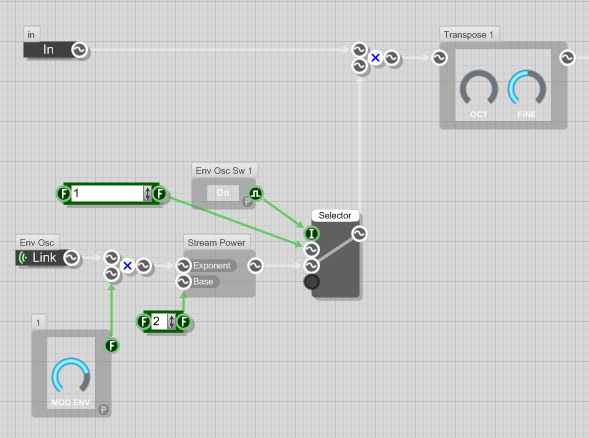

So you didn't want an envelope to modulate the osc, is it just an envelope to modulate the modulator of the osc :?
Re: Need some help mod env depth to osc?
Posted: Wed Mar 05, 2014 5:35 pm
by djbrynte
Ah sry i dont think i understand everything right. But i want envelope to modulate pitch of oscilator. But on -V-Station its -to+. And when i test the mod. Then its not in right pitch when turn the function on. It need to start on 0. Help me out here pls. And thnx for all help i getting form you xtinct.

I need so it starts on 0. How do i fix this?

0 is in the middle like the v station turn left for negative mod and right for positive. you may want to set the default value to 0 and turn the snap on so you can find 0 mod easier.
Ah ok thnx for rply mate. But when i test the knob is not on 0 when turn it on.
I have done exactually as you told me. But when i turn it on. It doesent start on 0.
The knob is set to -1 to +1 and defualt as 0. And i added stream power with float 2. When i turn it on it has diffrent pitch then 0.
Can i fix this some way? I want so when i turn it on the pitch start at 0.

What do you mean by "turn it on" ?

I have it connected to the pitch of the transpose. And i have on off switch for it. Mod envelope to the stream then from the stream power to a on off switch. And when i turn the signal on. Then its out of pitch.
Check the file i sent to you to your messages.
Mod envelope > Stream power > Selector > Transpose Pitch.
And the signal doesent start on 0 :/ When i turn it on its not the same signal. Its out of pitch :/

What i mean is that. When the envelope is connected to the pitch. I want same signal when the knob is set to 0. Now when i have this stream power added the signal is not set to 0 when knob is set to 0?
And i still want it to do that effect. with pitching osc.

Had a look at your schematic and can see where its going wrong, you were also adding the transpose and other mods to the same multiplier, best off keeping it seperate as below.
ENV MOD.png (35.44 KiB) Viewed 13504 times
you can also add it after the transpose but you must keep it seperate.

Ah ok thnx alot bud....
