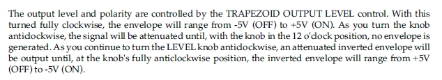

I have the trapezoid system working as described, and in poly mode too! Ranges set as per the PDF.
Next is to look at, and think about, the LFO mode…
We shall see!
Re: EMS VCS3 emu gets FS overhaul
Posted: Mon Jun 17, 2019 5:04 pm
Hook, line and thinker :geek: :D
You probably noticed this, but the other thing I got wrong is that the output of the Trapezoid is bipolar, like an LFO (but not to the VCA, I would imagine). [Now fixed in orig. post]

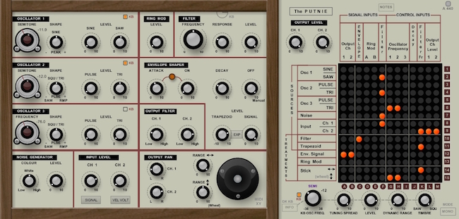

I think this satisfies the details in the PDF Kevin. I had a lot of fun doing this.
Please speak up if there are any issues or changes needed.
Posted: Tue Jun 18, 2019 8:36 pm
Wow - I am green with envy of your green-blooded prowess with envelopes - first the Voyetra's odd-ball and now this :D :mrgreen:. As far as I can tell everything checks out; I only had to change the Trapezoid output to be bi-polar:
Trap BiPol.jpg (64.12 KiB) Viewed 19643 times
I also made the env switchable linear or quasi-expo; the manual for the VCS3 and the one for the modular copy doesn't say which it was - I've always assumed most vintage EGs were expo due to the nature of the analog circuitry.
The ol' PUT' is now officially v1.03. Also went through the manual and got most of the signal ranges pretty close to right; this odd-ball had different output levels for each waveform. The joystick CV range was 0.6666 of the Trapezoid, etc. Because of the graphics in the VCS3 manual I'd always assumed the Tri > Saw/Ramp control was a smooth 'morph' of the shape, but the old synthesis book by Alan Strange (and he would know) clearly shows the VCS3/Synthi Tri shape control being a simple cross-fade, like the Moog Voyager; so with the uneven output voltages, the Tri output goes from a half-level Tri to a full-level Saw (or Ramp) -weird! I also got the Osc freq controls looking a bit more like vintage verniers - why not? :) :geek: I'd also neglected to make the Input amps inverting, so they can be used to invert CVs.
The PUTNIE os_v1.03.fsm
(1.62 MiB) Downloaded 1069 times
The PUTNIE_os copy.jpg (197.24 KiB) Viewed 19617 times
Thanks again ! - envelope-meister Spogg :D

The design is not mine - it's trying to look as much as possible like the actual synth - the EMS VCS3, nicknamed "The Putney".
This particular specimen is missing the silver caps on the knobs (or they are black on this one - hard to tell).
