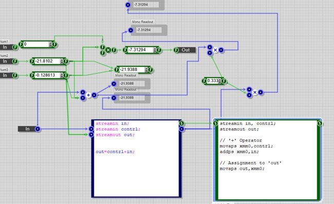

The main issue is that it will not sound the same when rendering faster then realtime.
Second issue is that the ticker can not be relied upon , so the sound might change according to the load on your cpu or project.

You are being too defensive in my opinion , the plugin will not render correctly, That is hardly what you are aiming for. People will not love that !? And the plugin will not always sound the same , people will not love that and unless you disagree that it will not sound or render correctly I cannot understand why you are being defensive?
it could also cause the user some headaches as one would never expect it not to work the same when rendering
You can fix this pretty easily as far as I can tell , you can add the floats to the stream like this.
streamin in, contrl;
streamout out;
// '+' Operator
movaps xmm0,contrl;
addps xmm0,in;
// Assignment to 'out'
movaps out,xmm0;
or just use a stream add ? unless I am missing something ?
And then just use a multiply stream for the 0.33 mult.
Same result , just sample accurate, apart from the rest of the circuit. ...

I am not discussing the validity of the approach , i.e using a leveler rather then a limiter, that is fine.
I dont know if you are just ignoring what I am saying but I will say it again, when you do a faster then realtime render in Reaper for example, which I do all the time , the plugin will not behave in the same way , i.e the rendered file will not level out in the same way as what you hear when playing.
I find it hard to believe that you find that acceptable ?

This was worked out many years ago, in the days of the ancient SM guru's who are no longer part of our little club. The tickers have been part of SynthMaker/FlowStone right from the beginning. In fact, in a way, they're even older than that...
The limitations of tickers arise because they are actually a (very old) component of Windows. All FlowStone does is to request the time interval and set them running, and Windows then calls back to FlowStone when each tick is due. Unfortunately for us, Windows timers have a fundamental limitation; 10ms between ticks is the shortest interval that is allowed. This is why Tick100 is the fastest one that we have. Even the general purpose Timer primitive works the same way; so duration values less than 10ms will be rounded up. There is nothing that FlowStone can do to make them go any faster, as Windows simply won't let them.
Windows timers also have a relatively low CPU priority, so the duration of a tick can be longer than requested if the CPU is very busy with other things. So when you're running a busy mix, a Tick100 might run substantially slower than 100Hz and with lots of jitter.
To confirm this, what you could do is set up a simple synth, then have a Ticker connected to a MIDI Note primitive to produce a very short pulse from the synth each time the Ticker ticks. Export this as a VST, and plonk it into your sequencer. Then, assuming your DAW allows it, do both a real-time render and an offline (faster than real-time) render, and compare the two. You should see that the pulses are further apart in the offline render than in the real-time one.
