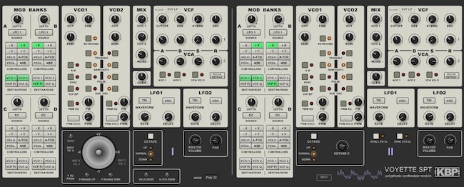

Just added a couple key features that I overlooked - since this mostly emulates the Voyetra Eight's 'Layer' mode (a left/right pair of poly voices), the V-8's joystick output could be inverted for the left voice (the hardware had one voice panned hard left, the other hard right; here each has a pan control, so in the plugin, it's voice 'I' that has it's joystick output inverted). The hardware would only invert the X output because the Y was hardwired to pitch only, and not available in the Mod Banks. Here, the Y output can be disconnected from pitch and is available in the Mod Banks, and the X and Y outputs can be independently inverted to 'voice' 1's Banks.
Also, when in 'Layer' mode the V-8's right voice's LFO rate controls are synced to the left voice. So added buttons in 'voice' II to sync each of it's LFOs' rates to those in 'voice' I.
Guess I better call this v1.01 at this point.
