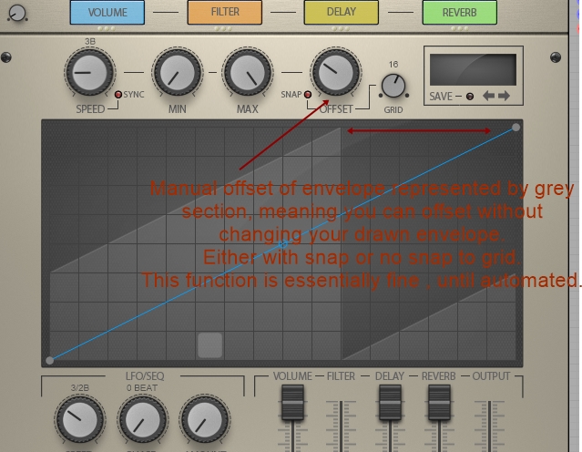

For example the Offset knob is at 0 at center and goes full ccw to -1024 and shifts the envelope until its back to the same position , same with moving it cw +1024 and it moves until its fully at the same position. With snap these values are quantized so moving the knob moves the envelope one beat value , essentially snapping to the selected grid size.

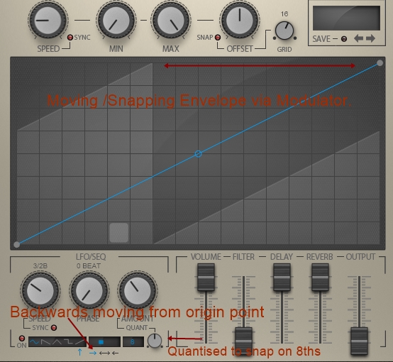

Offset , manual moving of the envelope , represented by they grey area.
Blue lines always stay at original drawing point and then grey area moves either with offset or LFO.
This function is mostly fine as its static , unless of course someone will automate.
LFO Moves envelope either with no snap , linear or snapped to grid via quantised LFO values.
It can either move backwards from origin point, forwards or in both directions.
Therefore the Shift Array prim being able to keep on shifting up to 2048 is needed.
moving lfo env.jpg (184.6 KiB) Viewed 15345 times
