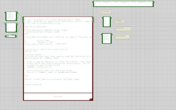

Here's a schematic sample that I'm working from:
With TROG's search routine as the centerpiece, I've only modified to take 3 Inputs. The 'working' Output shows
the result ... but in a format that I don't know how to use.
The 2 text boxes below that show the format I'm trying to get to.
Hope this makes sense ... or maybe I'm thinking about this all wrong :?

Here is my modified version with 2 inputs. 3 outputs element names,element index a combined array name+index. Oh and my skills with ruby are almost same as yours :D . I'm ruby noob.
search_array.fsm
(778 Bytes) Downloaded 1081 times
Re: ARRAY Search [RUBY] ??
Tronic wrote:like this?
Closer :lol:
The 'found' INDEX [output] should only be those found, and in sync to the patchnames.
Thanks for looking at this Tronic !!!!!!
TrojakEW wrote:Here is my modified version with 2 inputs. 3 outputs element names,element index a combined array name+index. Oh and my skills with ruby are almost same as yours :D . I'm ruby noob.
Hi TrojakEW,
Your latest 'modified version' .... WORKS !!! :D
Looking over the code, I see familiar terms and syntax that I was trying to use in my attempt. I did, however, see new terms, like the 'map!' tp get the index array. That's one I'd not seen before.
As to Ruby skills ... well YOU might consider yourself a 'ruby noob' ... :lol: but the code AND the internal comments you wrote are MUCH APPRECIATED 8-) I can actually follow along with your code ... still, I need to understand the internal workings, among many other things. This is great ! Thank-you.
Well, at least now I can start putting together the original idea, and see if this all comes together.
Thanks again for everyone's help in dragging along a rookie to a working destination. :lol:
