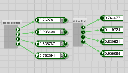

...but I noticed one more thing. Each time when I start the schematic - the random series starts from the same position (it calculates the same irregular patttern of numbers each time). How to put there external seed correctly?
Re: rnd optimization
Yes I know, but I have seed generator on start (time based; thus - it produces new results). That why I asked how to connect correctly and efficiently external seeding.
- seed-gen.fsm
- (575 Bytes) Downloaded 1000 times
your schematic always starts with the same values... as I said, the default random generator in FS works that way. You can use Ruby or set the seed input of the primitive explicitly to the current time.
MyCo - just tested again. Always different values.
For some reason - first value is sometimes the same, but not always (I think it was more vriated in SM, or in larger design or under greater load, don't remember now). Values are different each start. Screenshot is made of 2 startups (no changes, just starting the schematic and external printscreen; to not make biliv's choices - plus video).
For green randomizer - it is a matter of seeding with time AND retriggering on start (I received this explanation from Malc some time ago).
But this similarity of seeds guides me to the question. If this FS randomnes = just irregularity (i.e. always the same pattern per seed), then maybe the random generator itself (before "latch") should be running in the background (I don't know - few per second? tkc rate?), to produce greter variation? (connected to interaction generated by user?). //edit: this one is just a thought; I don't know what difference (size) between seeds produces signifficant differences in output (as you see this is click-by-click related, not audio noise).
