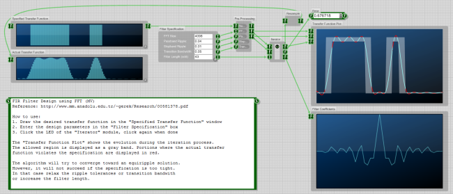

FIR Filter Design
Posted: Sun Jul 21, 2013 6:20 pm
MyCo wrote:I've added the FIR coeff generator from Martin (from the Stream FFT project) to the FIR that I posted earlier... works quite well...
Cool. 8-)
This reference was mentioned in a recent discussion over at KVR regarding FIR Filter design. Below is an implementation in FS, it is quite easy to use and fun to play with. So far it only generates filter coefficients and shows transfer functions, I haven't plugged it into an actual FIR filter yet. Comments appreciated.
