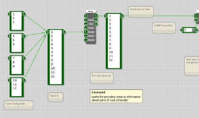

Well .... as embarrassing as this may be, I'm posting an example of the 'simpleton' method I've been using :oops:
Of course, it is because of this that I hope a much better way is shown :lol:
Here's a peek at part of the schematic:
Here's the small example
My current array save & load-1.fsm
(1.73 KiB) Downloaded 1037 times
As mentioned ... this example is about as crude as I can get it ... but, it does what's needed ...
But it is 'High Maintenance' [to say the least].
I hope to learn a much better technique ... maybe through the use of the PreSet Manager that I always include in any project.
So ... once the laughing and finger pointing stop ... please take pity on the rookie :roll:
:lol:
Thanks!

Re: General Preset Manager question.
Hi tester !
The trigger issue is something I've been now looking at throughout my latest efforts [having been made aware].
In a previous project, using my crude array stacking, save, load ... I have indeed noticed a lag or non responsive situation .... although it did do the job eventually.
In my current project, this entire Save/Load concept needs to be redesigned. I looking closely at your postings, and now to the 'excerpt' you sent. It is much easier to see from your schematic what you were describing earlier.
After just a brief look, I can see the trigger reduction ... but I wonder how that 'special' trigger you've added to the S&H's would be activated. Might the Button [used to actually initiate the write to disk ALSO trigger the S&H refresh ?? I wonder if that would happen BEFORE things got written ?!? A little confusing :|
The other major thought ... Is the 'array stacking' and the subsequent 'Array Splitting' an alright technique ??? I looked at the BUS prims, and it seems there is no array access available there :roll:
Anyway, still many questions with all this. And again .... the Preset Manager ... could this not handle everything ?!?
Thanks for all the help and education 8-)
OK ... from tester's excerpt, I measure a single trigger through the schematic :mrgreen:
I've added the Save/Load module from TROG to run actual tests.
Additionally .... in order to, both, trigger the S&H and the SAVE routine, I added a 'trigger Delay' going into the SAVE, and gave it 2 ms to first update S&H, then trigger the write to disk. This seems to work well. At this stage, I don't know if 2 ms will be enough should the data being controlled expands, or the complexity of the schematic changes.
Needless to say, the reduction to a single trigger is ideal.
The outstanding question/concern still remains, though ...
1. Is the Preset Manager only going to handle the knobs, faders,switches [as it does now], and therefore, all this User generated data must be handled separately ??? Or is there some important feature that is being overlooked??
Since I don't know, I feel compelled to ask about this.
If the PM is out, and we must use a separate routine and file ... then, is the splitting up of the Arrays [as I've done] THE [best] way to do this ? Granted, we can see that it yields the proper results ... so it is working ... but it can easily get messy to maintain and re-route this data about the schematic. I've used wireless feeds with the BUSSes to help keep some sanity in the wiring process.
Maybe I'm looking for something that is not there ... I just felt that my crude implementation was ... well, just that :shock:
Maybe I just need to hear Mr Cronkite tell me '.... and THAT's the way it is'. :|
and here's the lastest schematic ...
My current array save & load-2.fsm
(20.85 KiB) Downloaded 1046 times

tester
Posts: 1786
Location: Poland, internet
Post by tester »
Yyyy, offended? Who? What? Why?
RJ, instead of timer/delay, I would do this. Connect "save" button only to data gathering. Gathered array = 1 dataset and 1 trigger on output. Use that trigger (second link in order), to initiate saving (prim) to file. Thus - saving will start always after you created the array. It's the order of actions, and outputs from which you get triggers.
excerpt2.fsm
(20.67 KiB) Downloaded 1019 times
