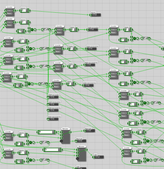

Here's a small snapshot of X11 "engine room".....
MyCo wrote:When you use something else, your accuracy is depending on Windows and CPU usage.
So according to your theory, the X11 is achieving this "Impossible" result by...Windows and CPU usage???
Well, Bill Gates must be pure genius with his design of Windows, because I'm running a 2.33 Quad core CPU that's the slowest version ever made, and is about 4/5 years old now. :)
So No.... I got to dis-agree completly at the moment Myco.
Will be happy to change my mind If someone can "explain" the above.
I've heard this type of theory a few times over the last few months....
MyCo wrote:As soon as your timing path relates on a green connection, your sample accuracy is gone
Yet at every turn, I keep making a "mockery" of it.
How long will guru's maintain this?.......and for what purpose?

billv wrote:So according to your theory, the X11 is achieving this "Impossible" result by...
When there is no load, it's possible, but it's not stable. And it's not a theory, it's how the stuff is build... Green Data flows in the GUI Thread, this means it's not depending on the audio processing at all.
Just to prove this, I've attached a schematic that demonstrates that there can be a time difference in triggers that were generated by the same event, even when they come from the same output.
