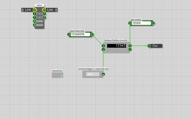

work continues ... but my 'solution' is not pretty
OK .. TEXT can be edited and it stays visible. The mouse cursor can also be placed within the text to make minor corrections. Seems to work alright.
There is still an overall display problem to solve. For example, if the width of the the display is dragged to accomodate the defined text LENGTH, when you hit edit, the first letter is cut off. It almost like the the display shifts left
Getting the color stuff ... well, through a kludge was able to provide a background color. This 'example' shows how not to program ... but it does show it working.
Text in the display can also be 'justified aligned'.
Text LENGTH is also controlled.
For additional INPUT [from disk] ... data can be sent into the EDIT BOX, and then further edited.
To note: The disk data is not subject to the LEN mod. Normally the disk data would come from previous entry [and limits] from the edit box ... so this should not be an issue.
I still need to add programming limits, etc ... but this is a basic idea that will need some 'elegance' applied
here's the latest .FSM
