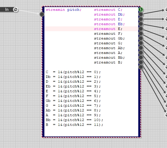

Also, it does not work in 64 bit alpha , the ruby script give me an error inside module?
Do you not have the alpha yet ?
Re: Triggering switches with Midi notes.
Posted: Sun Sep 30, 2018 9:11 am
by lalalandsynth
It seems to be ok if I delete some the notes ?
error 2.jpg (119.07 KiB) Viewed 15955 times
