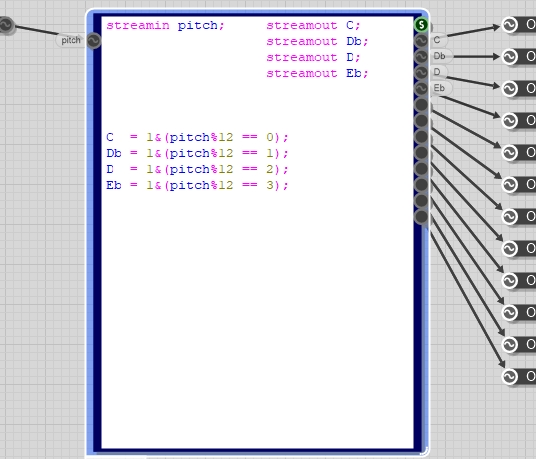

Also, it does not work in 64 bit alpha , the ruby script give me an error inside module?

Post by lalalandsynth »
It seems to be ok if I delete some the notes ?
error 2.jpg (119.07 KiB) Viewed 15944 times

I just wrote the code back into the ruby window and now it works.
