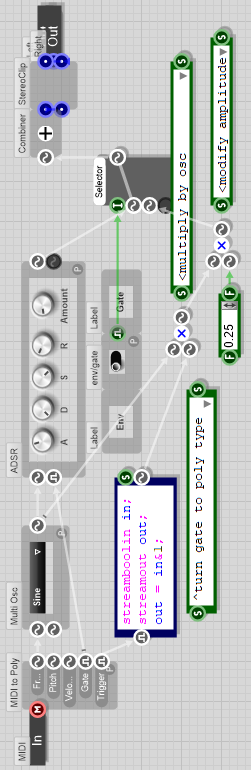

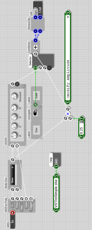

Here are images->
option 1_0.png (57.18 KiB) Viewed 17152 times
^this one doesn't use gate

^this one multiplies by gate
hope helps
