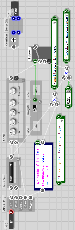

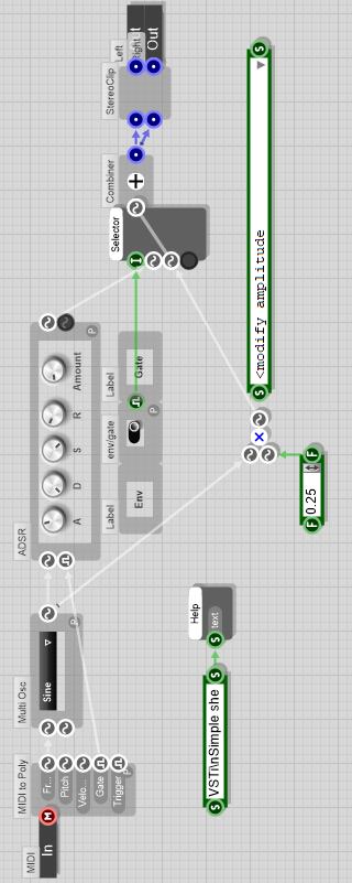

Here are images->
option 1_0.png (57.18 KiB) Viewed 17130 times
^this one doesn't use gate
option 2_0.png (59.46 KiB) Viewed 17130 times
^this one multiplies by gate
hope helps
