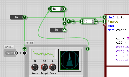

I'm struggling now with Seq 2, which is a Wave Seq set up. I'm creating the notes in green,
then feeding into ruby to generate the midi. Not 100%, it drifts, so now I have to re-design it
untill I get it right. That's the big difference now-is that We don't have to settle for something
that isn't 100%. We can just keep going untill we get some of that "precise timing" that's
talked about in the User Guide.

trogluddite wrote:Converting from Green->Ruby
Your "No backward trigger from Ruby" revelation has got me in a mess too Trog :D .
To use my Wave Seq, I need Ruby to automaticly read the @note.
Having to push it in has put me back into the green, I knew that would be trouble.

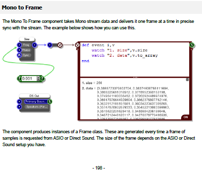

What's the deal with this Mono to Frame thing?
This "precise sync" statement is a bit of a turn-on.
Can it be used for a PPQ set up. ???
For me also looks like a alternate way to spit out data from my Seq or Mods, and bypass a lot of green.

Yes, I think you're on the right track. A frame is a collection of samples that is exactly one ASIO buffer in size, and totally in sync with the VST host. It's weird at first because we are so used to the SM "one sample at a time" way of doing things - but in reality, the host always sends data in buffer-size "chunks". SM has been hiding this from us for a long time!

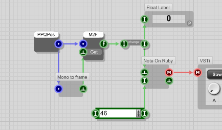

Last night i spent a few hours with the Mono to frame. Got some interesting results from it.
Seems it can be used as a "Ticker" extracting a green tick from blue.
( The Code in the Mono to frame module is the same from the User Guide.)

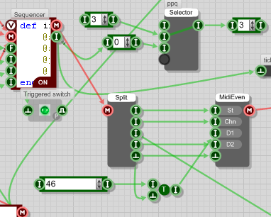

I'm still playing with the "silly" idea of bringing the Ruby accuracy down to green :lol:
Did about 6 versions.... this one is interesting, it's 100%, note is green. All I got to do,
like you said, is change it at the right time.
