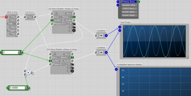

Maybe we just have to multiply the phase to get the wanted result ?
Here with X 0.49999 it have only one peak.

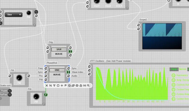

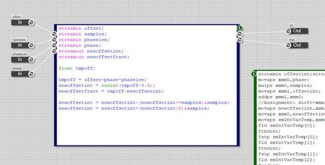

Well, in my own, stumbling, hunch-following, trial-and-error way, I seem to have figured this out.
Just putting this 'Add Phase' code from the iFFT osc between the original Razorblade osc 'Counter' and 'Interpolated Read' modules did the trick. Just needed to give the 'phaseLen' input a float of 168.562 (as in the iFFT), to set the Buffer Size, then the 'phase' input functions as expected.
A few minor wrinkles remain:
1. One-shots still double-trig (no biggy in a project to bypass the 'AddPhase' module for those waves).
2. The float range is strange to achive squ thru narrow pulse: 1.561 to 0.265.
3. Not sure the HiQ option is working, as the 'Add Phase' doesn't have both 'PosInt' and 'PosFrac' inputs; only 'offest'.

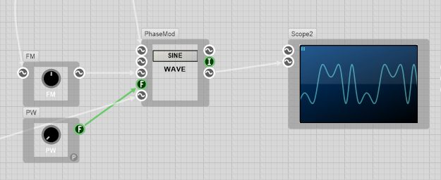

FM with two sines at Ratio 1:00 looks and sounds just as expected:
PW/PWM still work just fine, as does Sync!
I might be missing something, but so far everything seems to work fine.

Well, you’ve pretty much duplicated what I did yesterday!
I’ll share mine because there are a few differences. I “tuned” the float value so it roughly matched Martin’s sine osc in terms of the knob position giving similar results. The value seems to change the range of operation, but I haven’t yet got to grips with the DSP.
But there are differences, which interests me. MyCo’s version produces flat bits in the output waveform when driven at higher modulation deviations, whereas Martin’s sine osc doesn’t; it continues to fold. That means the timbre will be different at higher modulation values. Unless someone quickly beats me to it, I intend to investigate this and try to solve it.
I suspect the double triggering is due to the index wrapping around to zero when the modulation value takes it above the number of samples, so it starts again. But I haven’t checked that yet.
