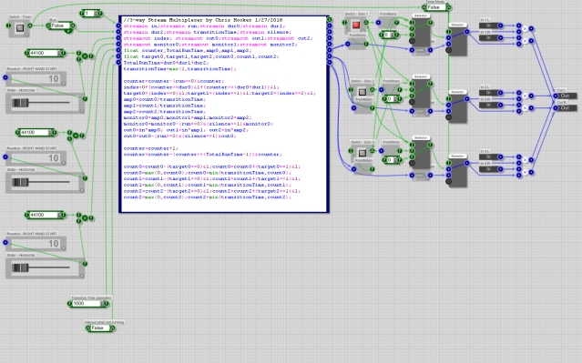

Okay, I just HAD to figure out a "dezipper" / transitioning code, so I finally got it.
Here's an updated schematic with both transitioning and a muting option when the "timer" is turned off.
Be sure to turn on the ASIO Out (or a Direct Out) to get the stream running.
If anyone knows how this can be refined further, optimized, done better in any way... I'm open to learning. Feel free to comment.
Nicolas, I hope this still fits what you need it for.

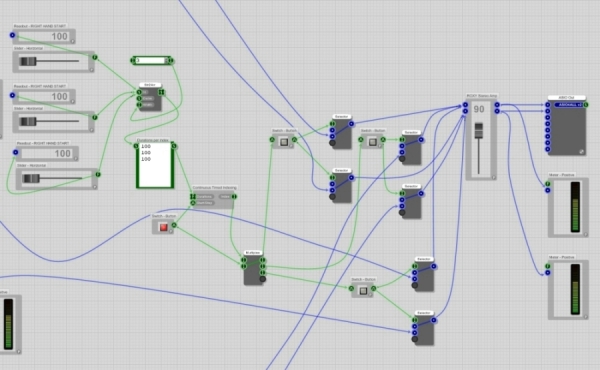

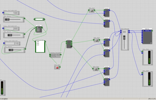

You can see on this schematic the times array and my problem with Str2Arr component when the time is < 100s.

Better picture. You can see input and output link.

Now that I can see your intent from your screenshots (the multiplexer is to supply an index for a selector, I've attached a new schematic that acts as a selector for your purposes. This way, you can use it as a soft morph from one stream to the next, instead of a hard switch. Hopefully this should work for you.
