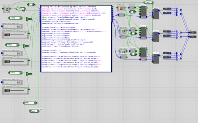

Okay, I just HAD to figure out a "dezipper" / transitioning code, so I finally got it.
Here's an updated schematic with both transitioning and a muting option when the "timer" is turned off.
Be sure to turn on the ASIO Out (or a Direct Out) to get the stream running.
If anyone knows how this can be refined further, optimized, done better in any way... I'm open to learning. Feel free to comment.
Nicolas, I hope this still fits what you need it for.
- continuous_timed_indexing - Blue condensed w transitioning.fsm
- (30.78 KiB) Downloaded 926 times

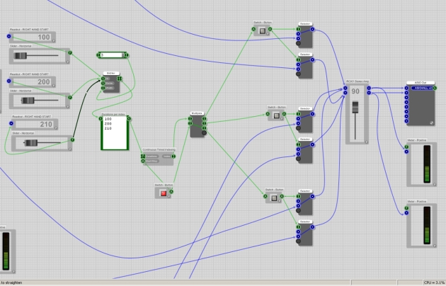

You can see on this schematic the times array and my problem with Str2Arr component when the time is < 100s.
Thank you again for your research, it's very interesting

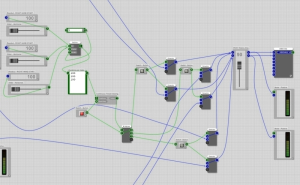

Re: 3 timers with loop
Better picture. You can see input and output link.

Chris and Tulamide, thank you very much for your good job. I am very happy with your help and I can found the best solution. I use ASIO output but with the Blue component, I have a Crash or freeze in my project.
When I push switch or if I have 2 switch ON, I have a bad noise. 3 switches are present for the "SOLO" mode. But I must customize this switches for enter signal ON/OFF. I must found a solution for have only the last switch in ON. So when I push the switch, others "SOLO" switches or "Timer" switch must be OFF.
I have fixed IP address and I can't change it with my Web Server.

Hello Nicolas,
The crashing was likely due to there being an ASIO Out in the original schematic's module. You can't have two in one schematic. In my last post I put it outside the main module, so you should not have an issue with that one.
Now that I can see your intent from your screenshots (the multiplexer is to supply an index for a selector, I've attached a new schematic that acts as a selector for your purposes. This way, you can use it as a soft morph from one stream to the next, instead of a hard switch. Hopefully this should work for you.
- continuous_timed_indexing - transitioned stream selector.fsm
- (69.39 KiB) Downloaded 929 times
