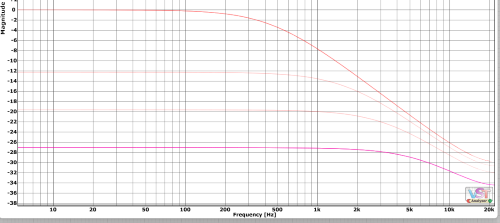

Hi Folks !
Today I was working on this reverb.
Something surprises me a lot !
In the leaky integrator I can observe that the contribution of and interact in the pole placement of the damping filter.
For me this linking is counter intuitive.
I mean, a leakage close to one is for short delay lines, they will be processed more frequently than long delay lines that have a lower leakage value (closer to 0).
but when leakage is closer to zero, cutoff frequency moves higher !
I tried to propose a basic modification to your schematic martin to demonstrate the difference in sound of another damping where cutoff is independant of leakage.
The push button on the interface enables this alternative filtering technique.
Please tell me what you prefer !
aCode: Select all
qI mean, a leakage close to one is for short delay lines, they will be processed more frequently than long delay lines that have a lower leakage value (closer to 0).
Re: FDN Reverb
Thanks for looking into this, francoisreme. You might be right, frankly I didn't spend much thought on the exact inner working of the reverb decay time T60 (it should really read RT60) and the (trebble) damping. My workflow is to set the reverb time to the desired value and then adjust the damping, not the other way round. Hence it does not matter (for me) if the corner frequency depends on the reverb time, as long as the range of the damping knob covers my preferred values. But of course other people may have a different aproach where it does matter. Your choice!
