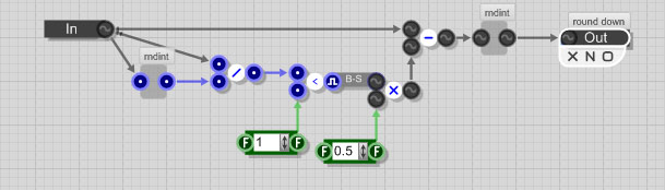

Re: PositionSyncedStepLFO - help?
thanks trog, hmm about the rounding down, i tried it with your way too but it didn`t work, i think its because you get values less than the int to be rounded.... am not really shure why it don`t work, the thing is when it should jump to 16 (4bars) the impulse is coming at 20 not at 16....
so the way how it works (don`t ask me why
) is to round the value -> divide the not rounded value with the rounded value -> if it is less than 1 subtract 0.5 from not rounded value and round it ! so it is always rounded down when it would be rounded up but you never round a value which is less than the int where it should be rounded to
so i needed to code it like this:
streamin floating;
streamout rndintfl;
float x,y,z,sub,rnd;
x = rndint(floating);
y = floating/x;
z = y < 1 & 1;
sub = z*0.5;
rnd = floating-sub;
rndintfl = rndint(rnd);
- rounddown.jpg (39.29 KiB) Viewed 28918 times

Nubeat7 wrote:thanks trog, hmm about the rounding down, i tried it with your way too but it didn`t work
Sorry, my bad!
I was thinking of another situation when interpolating sample counters, where you have to keep the integer indexes in the right order for the lowest CPU - as you say, my "fix" just moves the "0.5" problem bang onto the integers, so that whole numbers don't always round properly. Very silly mistake!
For proper rounding down, there is a simpler way...
rounded = rndint(x)
rounded = rounded - 1 & (rounded > x)If the rounded value is greater then the number you started with, then it must have rounded up - in which case, just subtract one. This will use way less CPU, as divides are one of the most greedy operations you can do, and the DSP code rounding is also not always very efficient (so that it can support CPU's without SSE2).
And of course, you can round up by doing the opposite - add one if the rounded number is less than the start value.
I tested it this time!
hmmm, but! like you can see at this schematic it is not working correctly! looks like it is still rounding up too !
i tried also a second way with the subtract method, looks that it is not working or did i confuse something in the code?
only the dividing method changes the int exactly in the same moment the float changes to the next int...
