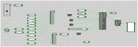

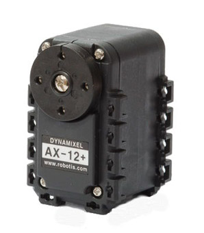

Here's a little FlowStone example of how to send data to the Dynamixel Servos.
For more information See: http://www.crustcrawler.com/motors/AX12/index.php?prod=63

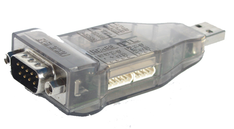

Here we use the USB to TTL (RS485) converter available from Dynamixel to send data to stings of Dynamixel servos.
See: http://www.crustcrawler.com/electronics ... hp?prod=65
In this example we uses a slider to send servo position to all servos (0xFE).
