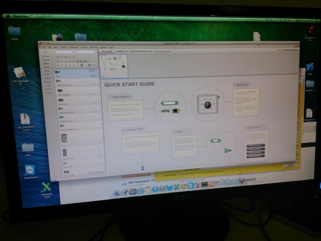

Post by chackl »
Well this is on of those Topics that might be hated by mac-haters.
Well i'm a 'little' hater too but there are users there outside that are let me say 'only able to work on mac'
So this Pic will get you up - and NO - this is no fake!!!
This is FlowStone Free runing on an OSX 10.8.5 powered with Winebottler:
(App gets arround 700mb :P)
Well - I have to say - it run for eaven 10 seconds before it crashed ^^
BUT:
I think i just got some settings wrong that are forced in WineTrick - WineTrick lets you Import libs from Windows example MS-Framework - some dialogs - AND GDX+ (called gdxplus)
I found out that FlowStone will Need GDX+ and the standart Windows Fonts otherwise the Programm Looks like a cutted peace of paper.
So my Goal is NOT to get the whole FlowStone to Mac - and NOT VST to AU!!!I want to get exported EXEs to mac-users.
And for that i Need to know some Basics:
What modules of Windows are used by FlowStone or FlowStone exported EXEs?
Example those i could get loaded:
GDX+ for Graphics
DirectSound for Sound
Force Sound to CoreAudio
But ther must be some more - because ruby is crashing all the time and i mostly could get it working for only 2 minutes
Shure! I'll post results if all is finished - Because this might be interesting for mac users ;)
Regards
C.Hackl
