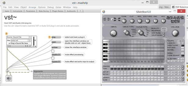

Here is a screen using the vst~ object in MAX/msp->
MAX vst host.png (153.33 KiB) Viewed 7131 times
The only reason I haven't done this is coz I cannot
rename the titlebar on the plug window--
it's broken and needs to be fixed by Cycling '74.
I have built all the VSTi/fx components in FS,
and will chain them with MAX, and compile an .exe.
Stupid bug, it makes it hard to differentiate instances,
to the point of unusable.
So u can make a VST host with this,
that doesn't spawn instances.
U can put ur own icon on it.
I think MAX/msp is like $250
