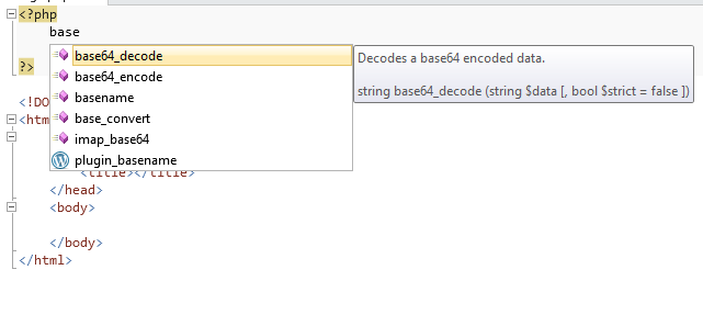

Webmatrix also cool:
PM me if you are interested.

you tried aptana(free) or rubymine (not free) also netbeans should do a good job?
after a quick search i think these are the most common ide`s for using ruby...
just writing the code inside there with all the ide features and copy / paste it after would be an easy and comfortable way to get features like this
but yes, some more features in the ruby module would be helpful, i want line numbers and better error infos too! :)
