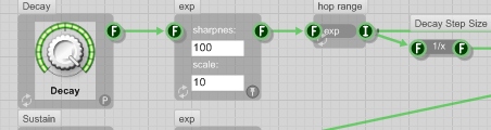

Maybe you could help me with this :)
What does the first part do?
I see a knob value with 0-1 comes trough. But what is sharpness and scale for?
The result of the "exp" box is bewteen 0-10 - the scale float multiplied the 0-1 result up to 0-10.
Actually I can simply delete the "exp" box and it still works. Is that exp-box only for making the knob exponential in it's behavior - like becoming more sensible in higher or lower knob ranges?
And the hop-box does what? Making it hop some samples to not be calculated?
The main variables needed before the code comes are: decaySamplesHoped, decayStepSize and curve( 1 to -1 )?
But I guess the code which calculates the decay is the most important. But it is written with the assembler - I don't understand that :)
Is the assembler more efficient in cpu usage than the code or why do you use it? If yes, how much :)
