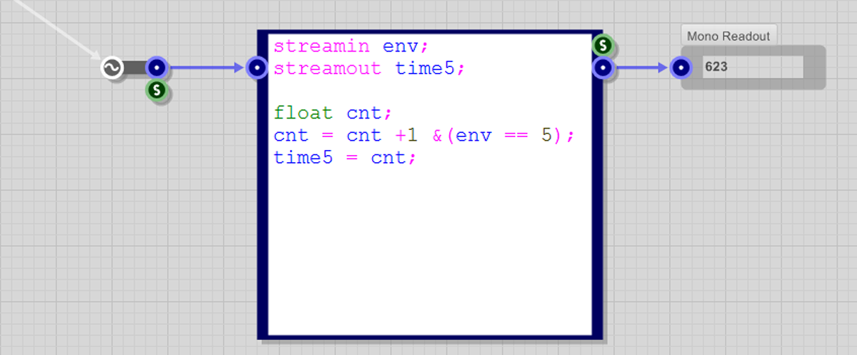

I couldn’t resist timing it, but I got mysterious results:
ASIO buffer 5mS: 35 samples at 5
ASIO buffer 10mS: 31 samples at 5
ASIO buffer 15mS: 623 samples at 5
ASIO buffer 20mS: 421 samples at 5
The number of samples varied a little for each note played and released, but were all close to the above values.
This was how I measured. The link on the left goes to the env output on the Env prim. Each time I measured I cleared the mono readout first by clicking on its blue input.
WTF?
WTF?
