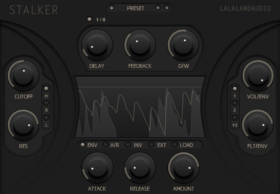

Stalker Envelope Follower
Stalker ENV.jpg (83.76 KiB) Viewed 15030 times

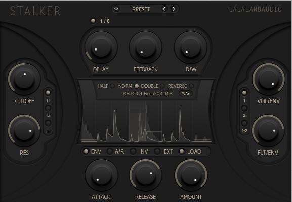

Stalker Loop player
Stalker Loop player
Stalker Wave.jpg (88.98 KiB) Viewed 15030 times

Re: Stalker.
I just noticed the volume in the knob slick. Had You thought of having a full circle behind it that 20% opaque with a dull gray with a hint of green? It would make it look like something 3d rather than a concept. I say so because everything else is, but then again it's a nice contradiction?
My youtube channel: DSPplug
lalalandsynth
Posts: 600
Re: Stalker.
Post by lalalandsynth »
Good idea, that might work , let me test
