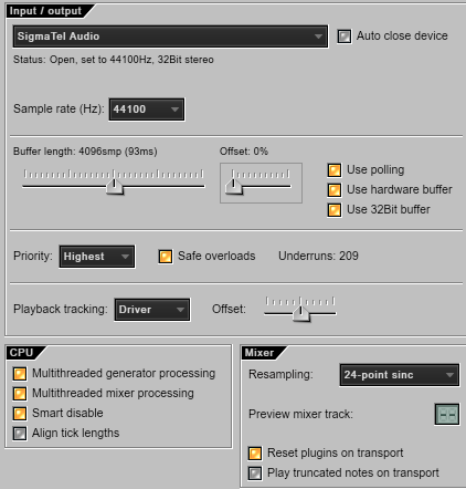

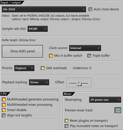

Now here are the setting's on my main CPU...
(Bear in mind here it's not my selections I want to highlight,
but the options that are available and how they differ)
Now Look at the settings on the laptop.
Clearly there not the same.
Can you use this information Trog, the technicalities are beyond me, but I hope it
triggers something in that monster brain of yours :D
