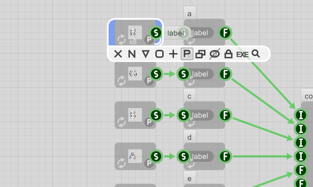

If you open the version in this link, all the “eye” symbols for the labels are crossed out:
viewtopic.php?f=2&t=14539#p47584

Spogg wrote:@tulamide
That's what I mean! There's only one label module, isn't there? And its eye symbol isn't crossed. Strange.

Then I think that what I'm calling the label modules must be misleading, sorry.
Here's what I'm seeing:
Invisible labels.png (47.94 KiB) Viewed 16315 times

Now I understand what you mean, and yes, they were meant to be seen (I haven't touched them and they are active on the original I uploaded on GURU, so I don't know what caused it), so thank you for the good deed :lol:

The really puzzling thing is that I had to make them all viewable individually. Does this mean you took the same action 8 times, then forgot?
