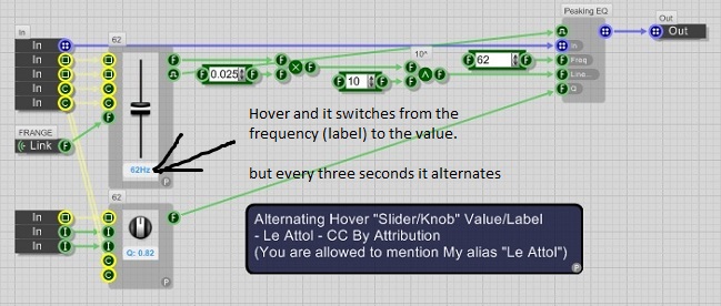

Hi all, I think it is very handy to make products that are more like those leading in the industry.
To do so, it is often necessary to save space. In the case of an equalizer or many other things it can be confusing to have
too many readouts and gauges. So in this example I show You how to save space and keep it simple.
So, let's get an idea of what the idea is about:
explanation
explanation
knob module explanation.jpg (75.05 KiB) Viewed 14834 times

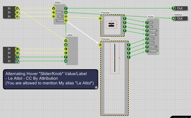

allright; so first ensure that you are capturing the active state of the slider or knob:
interaction within
interaction within
interaction module within resized.jpg (91.57 KiB) Viewed 14834 times

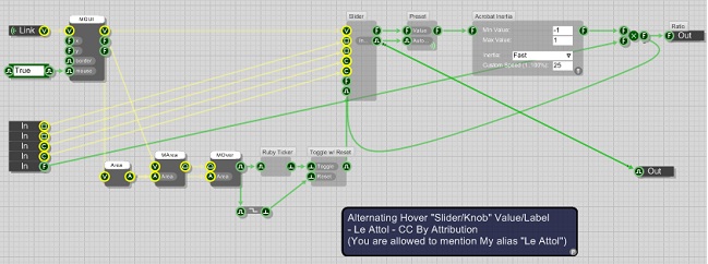

Allright, simple enough; but notice the module labeled ruby ticker here?
knob within
knob within
knob module within.jpg (62.82 KiB) Viewed 14834 times

so, the ticker (love the ruby version) should only initiate if that the slider or knob is active.
And let's go into the ruby module and see how that is done )
The attachment within ruby ticker module.jpg is no longer available

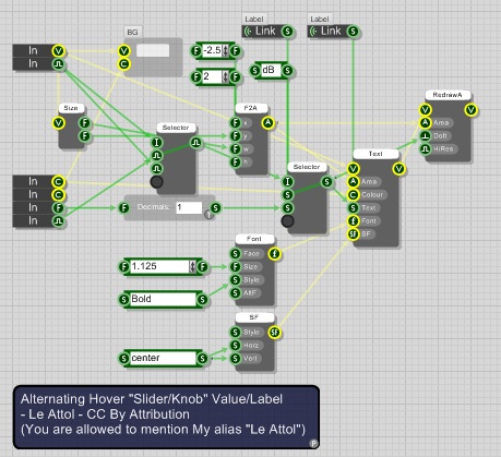

and this is good. now let us look within the label module and see what I did:
inside label module
inside label module
label module within.jpg (80.43 KiB) Viewed 14833 times
